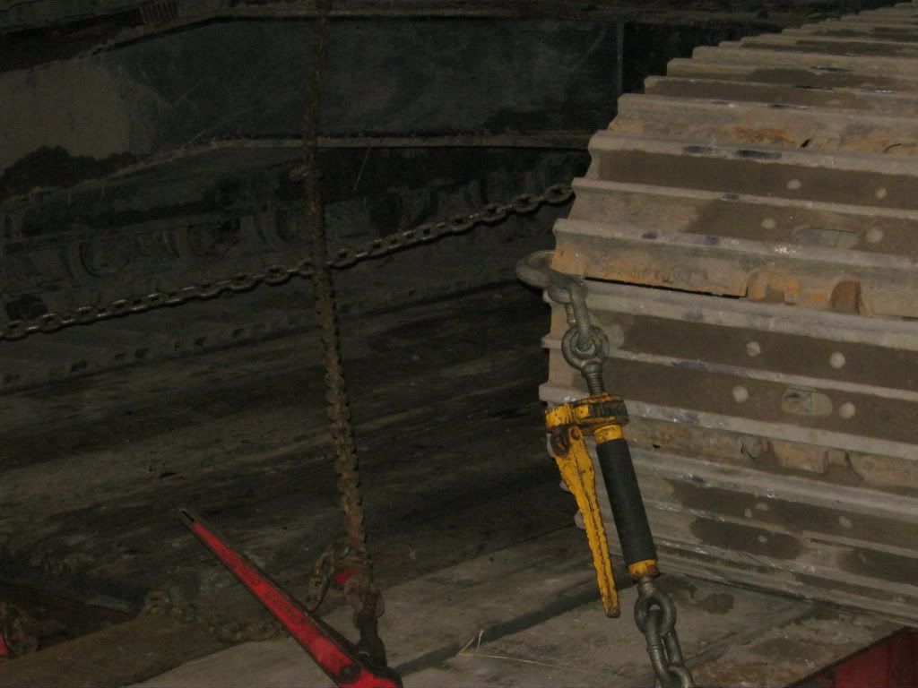

Mackman, on a excavator that small there is nothing wrong with four binders hooked directly to the tracks and one chain and binder over the bucket. Forklift looks good. There is nothing wrong with using just two chains in that way as long as you have the four binders.
Just remeber that if you hook a binder directly to the machine the working load limit for the binder is cut in half. Like if you have a 3/8" binder rated at 9,500lbs when hooked direct it's only worth 4,750. Make sure though that you have atleast half the weight of the machine tied down as that is what is requierd by DOT.

This is the only picture I have of how I tie down evcavators. This John Deere weighed about 56,000Lbs.
