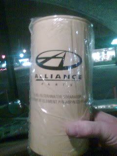

Thanks for the guidance WW and the rest of y'all.
I now have a spare on board. I was pretty sure that there were a number of folks on here that were worried sick that belpre might experience mechanical difficulties at 3AM on some old country road, and freeze his arse off for quite a while until a service truck arrived. Your concern is much appreciated! :lol:
