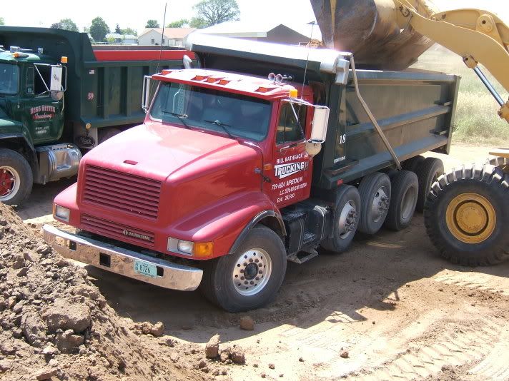

What is the difference between a Paystar model and 2674 model International truck....I assume just the way the body looks? (since most of the rest of the truck is just different components bolted together)....again which is better if there are real differences as far as durability, parts availability, maintenance and repair costs?
The Paystar wins that competition hands down.
We've got S models and Paystars at the company where I work and the Paystar is a much more heavy duty truck.
Just look at the front suspension on a Paystar with the massive trailing arms which take all the fore and aft stress the front axle encounters during rough off road use, compared to the S model, which uses a conventional front suspension in which the spring itself serves to deal with the fore and aft stress which can result in broken spring eyes and broken spring centerbolts.
Also keep in mind that the S models were discontinued around 2000, but the Paystar lives on to this day as the 5600i, which still proudly wears the "Paystar" badges on the hood.
Here's a 2007 5600i Paystar which we built into a dump truck last year:
