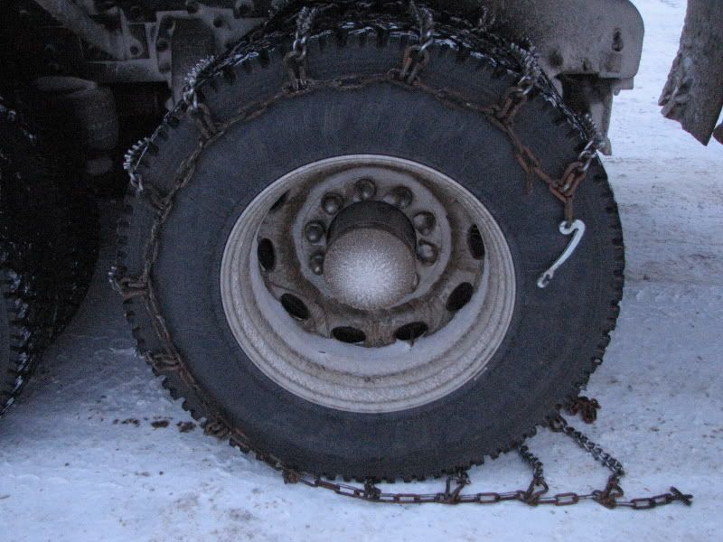

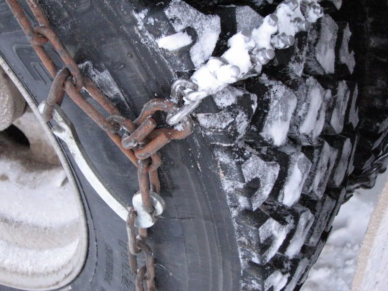

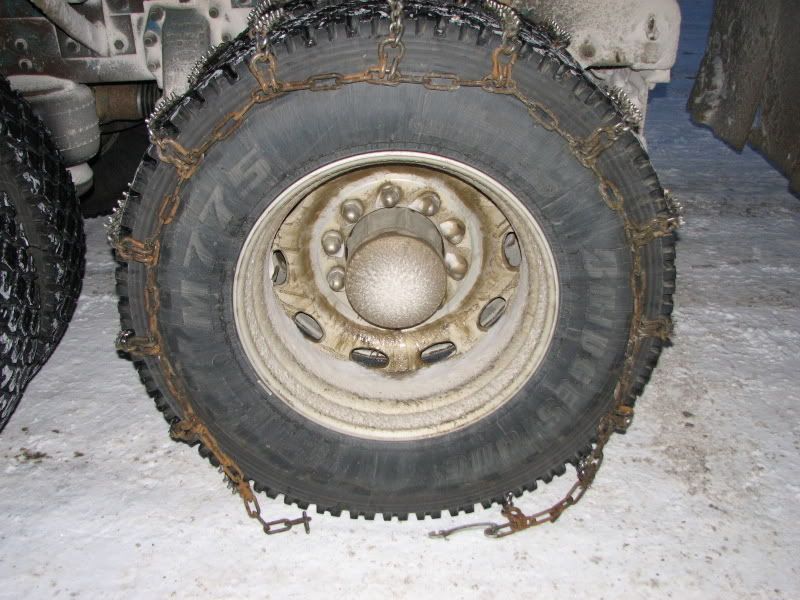

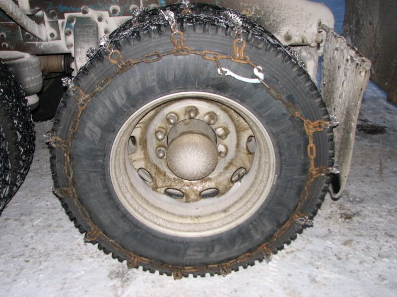

Originally Posted by COLT
Originally Posted by LadyNorthStar
Santa is NOT coming to your house next week.
Santa likes ME :wink:
Step one, throw the chains on making sure not to drive onto your chain ends when you drive onto the chains.
Step two, drive ahead until your chain ends are at the 1 or 2:00 position.
Step three, tighten chains up.
These chains are very tight fitting as they are new, and they are on a high volume tire casing... I had to hook the ends and roll ahead a few rotations to get enough slack to close the boomers.
New tires, new chains equals a harder chain up, this took about 8 minutes for both sides.
This is a boomer, half hr. down the road, still tight, and I didn't retighten, still on first link.
No bungies needed
