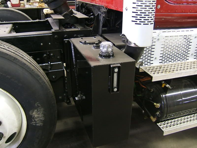

Here's a photo of a truck I put together where I work, showing the external air fill, just below the top step.
In our case we put a "male" shop air hose connector and a shutoff valve on it, that way we hook an air hose on, open the valve and pressurize the system. Once pressurized, shut off the valve and disconnect the shop air hose.
You can substitute the aforementioned Schrader valve for the shop air connector and shutoff valve.
