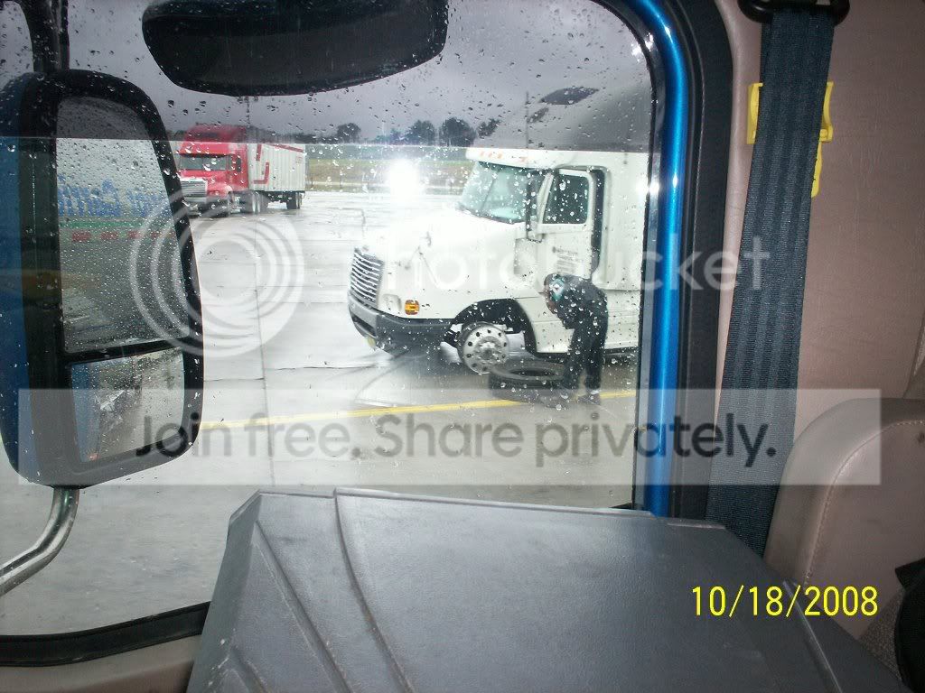

Sadly....I think you may be right! I can't tell you how many times I have seen drivers get out of the berth, crank the engine and leave a truckstop or rest area..... like this guy....
I pulled in next to him at a truckstop in SC on I-95, the curtains were drawn....I saw he had a flat tire on the left front steer. I went inside, and when I came out...that's what I saw. Yep, he did a GREAT pre-trip!!
And he made a bunch of people happy...he did it right in front of the fuel island....
You gotta do it, and you gotta do it right!! Or like Myth_Buster says....its gonna cost.
