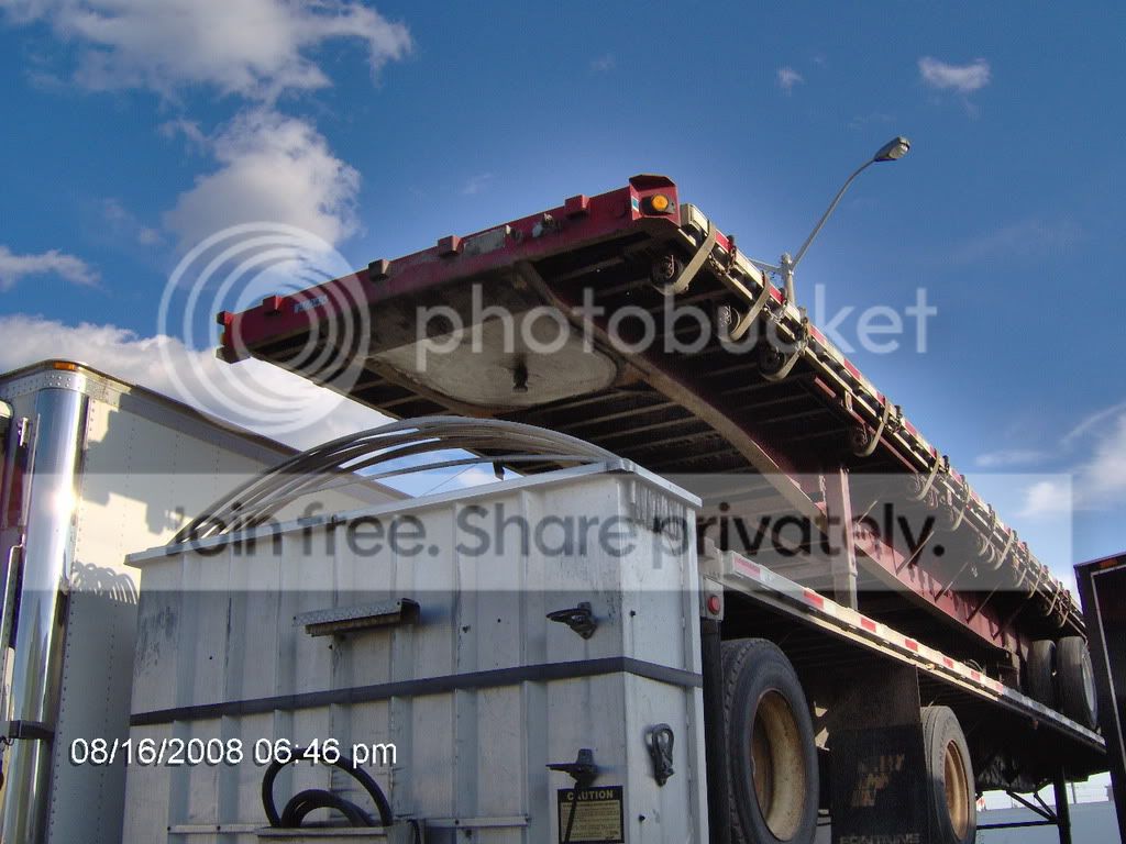

Looked at the trailer. It's very worn out. I didn't mind the rust on the frame, but the floor was flexing under my weight! I called the sales guy and told them I wouldn't take it for $5,000. See the pic (it's the one on top).
