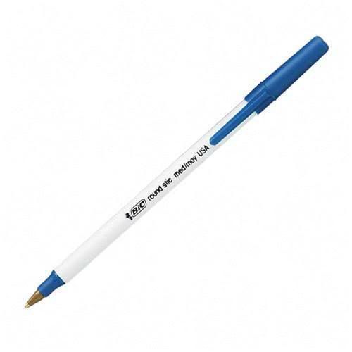

Well, I ain't no engineer, and I'm not in favor of this remedy, but....
If I'm not mistaken, it is not VOLUME of air that holds back the spring brakes, nor VOLUME of air that applies the service brakes. It is air PRESSURE.
And, unless I'm mistaken, the pressure of air OR a liquid, is increased by narrowing the diameter of the "line" it is forced through. I know when the water line to my house was replaced with one of larger diameter, my water pressure dropped.
The air compressors of trucks produces MORE pressure than the lines will hold and therefore the excess is released by the overflow valve. Using a smaller bore within the line "should" only INCREASE the pressure of the air, holding back the spring brakes just fine, and applying the service brakes just fine. The increased "excess" will just be expressed more often by the release valve on the generator tank.
Of course, I COULD be wrong.... cuz I ain't no enguneer! I'm just a truck driver.
Now.... IF I was to employ Windy's procedure.... I wouldn't tape the ends of the pen cylinder with duct tape (which is porous and will pass air) to fit the inside diameter of the hose on either end. I would slit the ends of the hoses, and overlap them (if necessary, or cut a "V") and just clamp them down real tight to the outside diameter/surface of the pen!
Snip, snip (to remove the damaged part of the hose,) slit, slit (the ends of the hose, insert the pen shunt, and clamp it down tight on both ends. DONE in less than ten minutes! Back on the road, and heading for line 5 time while the shop repairs it to specs! :thumbsup:
But, what do I know? :smokin:
Actually a reduction in ID will DECREASE the pressure, at least in the prtion of the passage that is restricted. It's how the venturi in a carburetor works, it's what makes airplanes fly. Google Bernoulli's Principle.
But you did ask a really good question- What do you know? LOL!
I think if you can brakes to release at all through a Bic pen, it will take a long time (because of the restriction) and it would take so long to get any serious application of service brakes that it would be unsafe.
And if, God forbid, you were in any sort of accident while underway with this "fix" a lawyer would have a field day with it.

Ummmm.... Hobo... Do you believe that a projectile fired from a weapon will have more velocity at 30 yards than at the muzzle????
The pressure dropped because while the lines in your house were replaced, the line coming into your house remained the same. Now, what happened to the volume of water available?
In the air brake system of a truck, the pressure and volume work together. You have a specific volume that must be brought up to a specific pressure in order to do the job.
And, for the rest of you... The barrel of a bic pen can be made to do the job, but you may have to cut the end off that the point goes through. It means you won't be using it for writing again. That gives you more volume of air available. No, DOT will not like it, but then, I'm not going to flag them down and point it out to them either. And, I'm going to get a proper fix on it at my earliest opportunity.
Yup... You're wrong, and you're right that you "ain't no engineer".:lol:
That is, unless you're driving a truck that does not have an air govenor on the air pump. When the governor shuts off the air pump because it has reached the max air pressure, it also releases the air dryer, and the sneeze you hear is not excess air pressure, but a quick discharge of air from the dryer to clear out any moisture. When the governor senses enough air, it shuts off the compressor, the air dryer goes "CHOOW", and the compressor waits until you use enough air to have the governor kick it back in.
:lol: :lol: :lol: :clap:
And just where do you put the clamps so that you do not lose air at the end of your slit, or at the bottom of your "V"???? I wouldn't use duct tape on the barrel of the pen. But I have successfully used black electrical tape, and placed the clamps so that they were on top of the tape. And, that was with the small hole of the barrel cut off.
Again, DOT won't like it, but I'm not sitting on the side of the road.
  #48
Old 01-19-2009, 06:01 AM
As I stated when I originally suggested the idea, the pen needs to be disassembled prior to using it, so you have only the pen shaft. The "tip" that the pen point comes out of is a separate piece (on most Bic pens, the shaft is white and the tip is black or blue), and must be removed prior to using it for this temporary fix. The idea behind it is to keep the air line from collapsing on itself by putting something rigid inside it before you clamp it with hose clamps.
