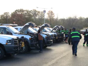

Drivers perform their Pre-Trip Inspection Tests
The pre-trip inspection is important for safety.
