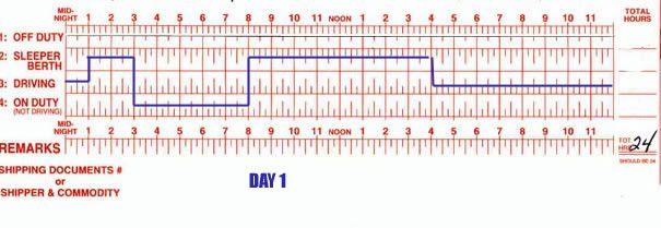

So, according to your stellar and insightful advice above, apparently this log is perfectly legit:
Driver drives for 1 hour after a 10 hour break, then goes to sleeper berth for 2 hours. He then unloads for 5 hours, before going into the sleeper berth for 8 hours.
http://i84.photobucket.com/albums/k1...sago1/day1.jpg

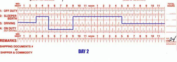

After the 8 hour break, he follows Dawn's advice:
Originally Posted by Dawn
3 simple steps to figuring out when the 14 hour is up and how much driving time is available.
Always add driving time in between the 8 & 2 breaks subtract from 11 and that is how many hours you have available to drive.
Since he has zero hours of driving inbetween the 8 and 2 breaks, he drives for 11 hours before going into the sleeper for 2 hours.
http://i84.photobucket.com/albums/k1...ago1/day-2.jpg
Is this the same advice that you give to the drivers of your employer, Dawn? :roll:
Dawn 02-22-2007 01:03 PM
DAWN: Always a day late and a dollar short. :lol:
If you read my full advice and not just how you figure the driving time!
There is 3 steps! The first steps are figuring out the 14 hour!!!!!!!!!!!!!!
Step 1: go to the end of the previous break! Count over 14 hours! The mark in your day 1 would be 5:00 pm when the original 14 hour ended.
Step 2: Go to the end of the previous break! Look forward do you have an 8 hour sleeper break? Yes: The count over 8 hours from your 14 hour you just figured on step 1. This would make your 14 hour end @ 1:00 am.
Step 3: Add up driving times between the 8 & 2 hour break; subtract that from 11 and that is how many hours you can drive as long as the 14 hour allows this.
So you would not get the full hours available in this situation because your 14 hour ended @ 1:00 am. So this driver is in violation from 1:00 am
This is why stressed 3 steps to figuring it out! Not the 1 you are focussing on! :roll:
