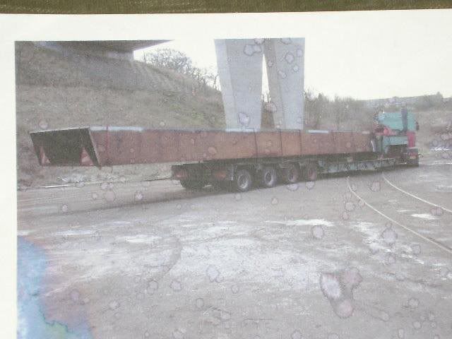

I`m fair close to it!(lol) I backed this on my blind side into a factory in Doncaster. That trailer has self tracking, which makes reversing even harder.
http://i72.photobucket.com/albums/i1...e/untitled.jpg

Lol
I stand corrected sir.
Nobody but WOT is a supertrucker heh.
I once saw two guys pulling double 53 lowboys in the jacksonville pilot. THOSE guys were supertruckers.
When those guys have taken class 4 rail carriages into London with all its narrow streets and horrendous traffic, thats when I will bow to them; not before.
Again, with tongue in cheek :wink:
