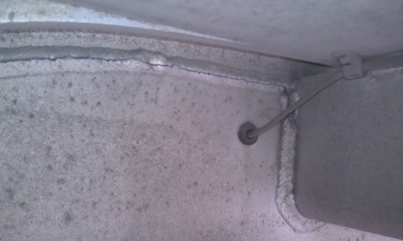

    6 years old
    5 year warranty
    Frame is cracked right at the neck. Never overloaded or abused by me. I can't say that about the previous owner.

    Pretty sure the last one is the death sentence. The other four are fine because it's along a weld.

    I'm no expert though I have done quite a bit of welding. Doesnt metal crack on the side of the weld? it seems pretty weird that the welds themselves all cracked. I'm thinking there is something quite wrong with their welding process.

    Yes that sucks. I would say those welds are crap also...not going to do you any good though six years after the fact. I could be worse though. You can fix that. Here's my story. It may help.
    Approx 5 years ago we had a 1995 Reitnouer step that cracked all the way through both main beams directly forward of the 1st axle. It was cracked through one flange and the web. I thought the trailer was scrap. We took it to a Reitnouer certified repair shop on Appleby Line in Toronto. They charged us a boatload of money to weld it and the repair lasted a week.
    This time we did it in our shop. Gouge out the cracks with a die grinder to create a good weld joint...this is important. MIG weld (or GMAW same thing) it back up (this is likely to require a pretty good size machine and some preheat). Then for some insurance against a bad design, we bolted some big fissure plates on both sides of the web using stainless bolts. Then welded around the fissure plates. Can post pics if you like. Judging from what you've posted on here before, I know you and your dad can handle this.

    East has agreed to fix it for free due to "defects from the time of manufacture".
    I have to flatbed it 1250 miles each way, no big deal really.
